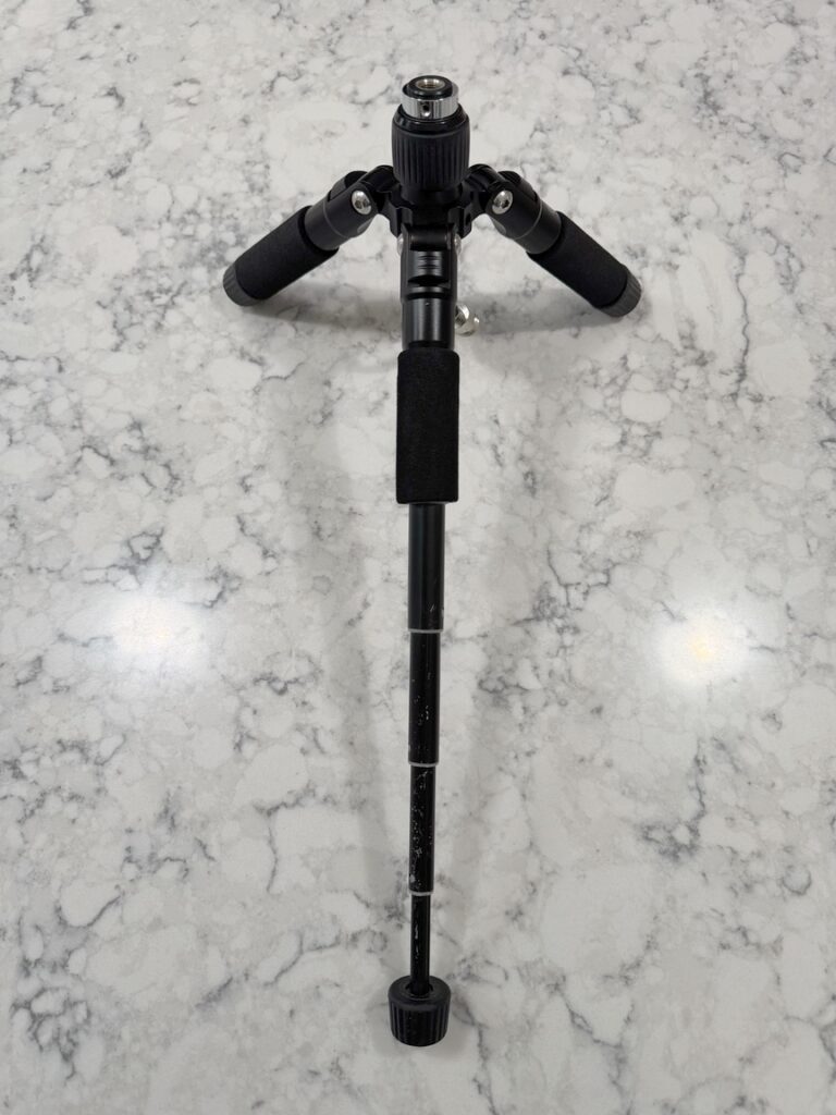

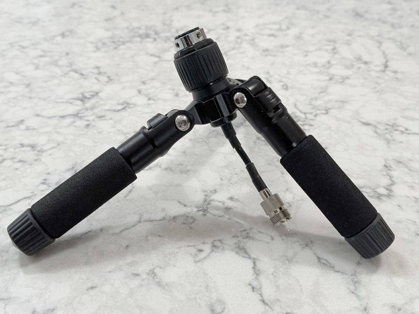

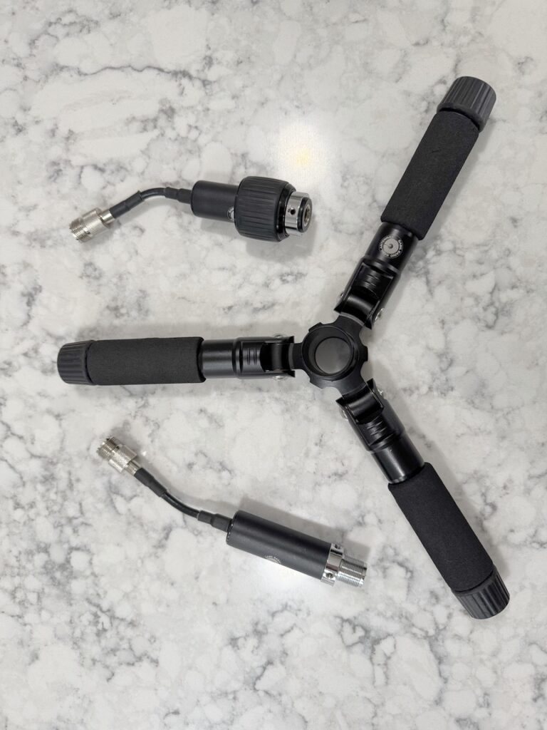

That’s a long introduction to a tripod! The GRA-ULT01 comes with two mounts, one with a 3/8×24 thread and one with an SO-239 UHF socket. This covers most of the commercial portable verticals that you’ll find on the market. Both mounts terminate in an SO-239 UHF connector.
Along with the tripod comes a UHF and a 3/8×24 mount.
The tripod is crazy versatile. It has four different length detents and multiple angles for each leg, so you can set it up on just about any surface, uneven or not. I tend to extend the legs out as far as they go to get a wide, low base. The feet are used to loosen and tighten each leg. A feature that delights me is that if I want to extend a leg by two lengths, I can just turn the foot two ‘clicks’ and pull. It comes right out to two.
Multiple lengths and angles adapt to any surface.

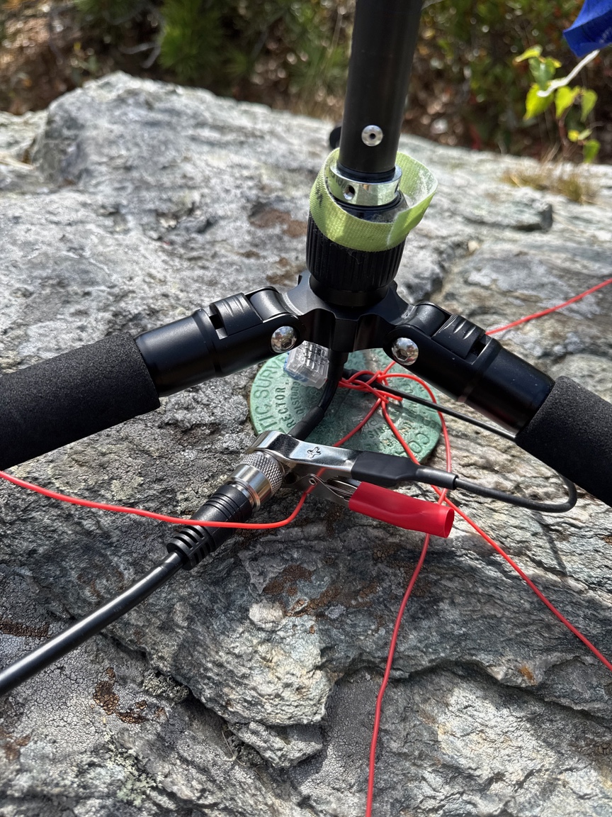

Here’s a look at the REZ 17′ vertical mounted to the GRA-ULT01 from two different activations. The closeup shows how I attach the radials directly to the shield of the coax.
The tripod’s only flaw is the grounding system — easier to attach directly to the shield.
This brings us to the unit’s one design miss. There are three tiny (and I mean TINY) machined screws with even tinier integrated spring-loaded studs that are supposed to be used to attach a ground or radial lead. I don’t even know where mine are, I might have thrown them away at some point, or more likely flung them into a creek or simply dropped one and couldn’t find it on site. If I had enough time I might be able to come up with a worse solution.
Instead I just use a clamp to chomp down on the coax shield. Electrically it is the same, and practically it is a LOT simpler to deal with than those silly spring-loaded bolts are.
