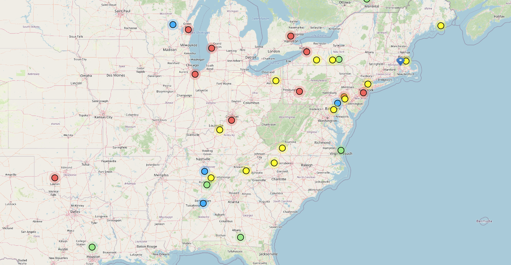

Spot Colors / Show All Spots
The initial view shows all data.
This first image is the default view, and it shows more or less everything. The map here is scaled to a section west of my QTH. Here’s the color code:
Spot Color Meaning
Green Your own activations
Deep blue / black Zero activations (ATNO)
Gold ring Park has a PN&R review available
Pulsing red, yellow, or green Currently activating (see Current Activations below)
Pulsing purple New park in past 30 days (click to see why)
In some areas of the country there aren’t many ATNO (All-Time New One) parks left, so keep an eye out for any new ones that might pop up. Check any pulsing purple spots you see on the map to check if someone’s been there yet or not.
